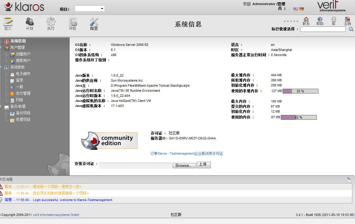

how do i active the message_zh_CN.properties file?
for my test, i renamed the zh_CN file into en, so my site is now in chinese, please see attach

The _en message bundles are the fallback solution when no support for the system language settings have been found.
I was blind guessing that your system locale settings are zh_CN but they obviously are not, as is shown on your screen dump (it shows en for the system language).
To force the zh_CN language you should add the following line to <installation_dir>/bin/setenv.bat:
set JAVA_OPTS=-Duser.language=zh -Duser.country=CN %JAVA_OPTS%
Or if you are using linux add the following to <installation_dir>/bin/setenv.sh:
JAVA_OPTS=-Duser.language=zh -Duser.country=CN ${JAVA_OPTS}
If you succeed the system settings page in Klaros should show zh for your language (country is not listed there).

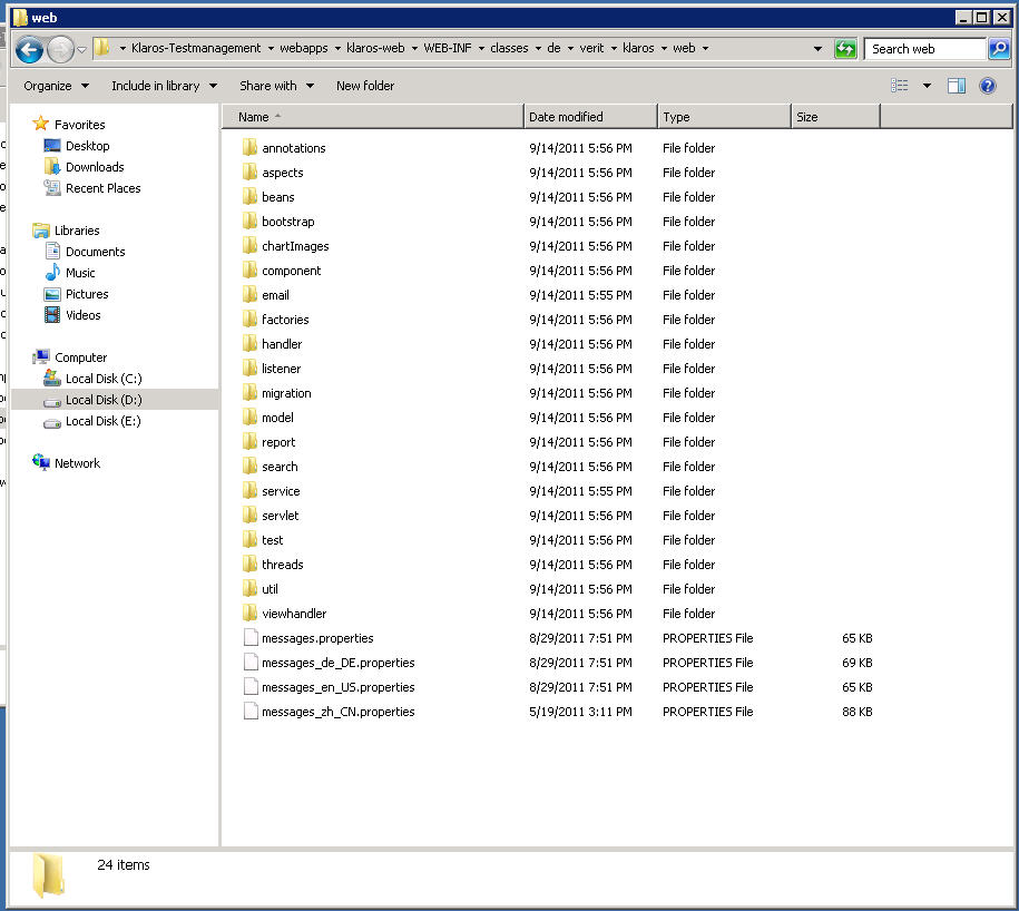

I have added the properties file into the directory of
D:\Program Files\Klaros-Testmanagement\webapps\klaros-web\WEB-INF\classes\de\verit\klaros\web
then i also have restarted the services, it cant seem to load the file into the control panel as a custom language as described in the manual.

the properties file should be placed in the
<userhome>/.klaros/resources/messages
folder in the home folder for the user running Klaros, e.g. by default in Windows XP this would be
C:\Documents and Settings\<username>\.klaros\resources\messages
This folder is searched during startup and when "Refresh message files" is pressed.

Ming Li, modified 14 Years ago.
RE: Multi-Language support
Youngling Posts: 10 Join Date: 5/18/11 Recent Posts
that explains it...works now.
thank you!
