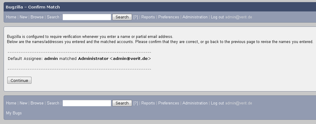

I am struggling to create issues in bugzilla with klaros.
My installation consists of:
bugzilla 4.2.1
klaros 3.6.4 - Build 32 (2012-06-14 16:23:35)
Validating the url of the created testmanagement is successful.
But I get two different error (depending on the project/product in bugzilla)
The error itself occurs when I try to save the issue for the selected IM (components and versions were loaded)
First variant of error message
second variant of error message I get for a different product which was also successfully validated in the IM management menu
"Unable to save the issue: java.lang.IllegalArgumentException: Invalid uri '/enter_bug.cgi?product=almex.optima.touch SA Cash': Invalid query"
When I attach the invalid uri from this error message to the bugzilla serveraddress the mask to enter a bug for the correct project opens (as expected)
bugzilla 4.2.1

Torsten Stolpmann, modified 13 Years ago.
RE: Problems creating issues in Bugzilla with klaros
Hi Gregor,
thanks for the update.
Regarding Point 1:
this seems to be related to the Confirm Match feature in Bugzilla (see attached image) which seems to be interfering with the server communication. Possibly setting the confirmuniqueusermatch option to false will remedy this situation.
Regarding Point 2:
Well spotted, I agree that there is what I consider a bug in the mylyn bugzilla connector (The URL is generated by string-attaching the product id instead of quoting it). I see to that this is reported there properly.
Renaming the product should be able to circumvent this.
Regarding Point 1:

Youngling Posts: 3 Join Date: 6/27/12 Recent PostsTorsten Stolpmann:
Regarding Point 1:
No, still not working when setting confirmuniqueusermatch = "off"

I will try to look further into Point 1 next week.
