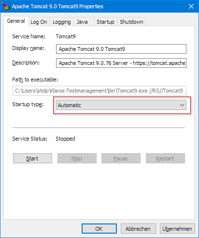

- In tab 'General' set the Startup type to 'Automatic'

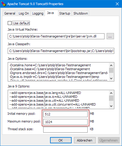

- In tab 'Java' set the memory pool parameters

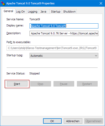

- Return to tab 'General', apply the changes and start the service
