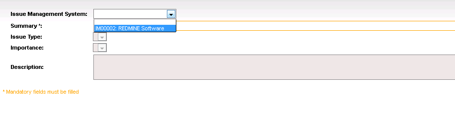

I want to add an entry into: Issue Management... but every time a get an "User/Password error"...
Does somthing special to do ?
URL=> Root url of redmine install
Project => Project name when I want to report...
I've create a user "Klaros" with test password "Klaros" into redmine and add it to the project...
I need to do somthing more ??
Best,
Mike

Michaël Erni, modified 14 Years ago.
RE: Redmine
Youngling Posts: 18 Join Date: 6/28/10 Recent Posts
Re,
Pffiouu... No Luck for me
By the way:I've configured 3 differents "IIssue Management System" I've select REDMINE Software as default.
When I want to create an Issue I have only the default one on the list (png attached).
Best,
Mike
Best,
Mike
Torsten Stolpmann, modified 14 Years ago.
RE: Redmine
I think you missed to add those 2 other to your current project, IM's are assigned on a per project basis.
