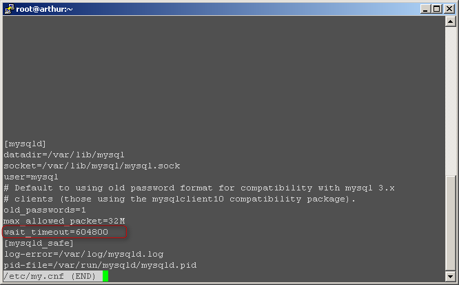

I recognized a problem concerning database connection handling. After some hours of Klaros inactivity at night I always get the following exceptions at first login in the next morning:
I already added these settings to the file 'hibernate.properties':
...but that doesn't seem to help. After this exception occurs the connection is established again and after getting two internal errors in Klaros I can continue working normally.
So my question: Is there any opportunity to avoid running into database connection timeout?
Thomas
08:24:46,927 ERROR JDBCTransaction:95 - JDBC begin failed | |
com.mysql.jdbc.exceptions.jdbc4.CommunicationsException: The last packet successfully received from the server was 53.510.109 milliseconds ago. The last packet sent successfully to the server was 53.510.110 milliseconds ago. is longer than the server configured value of 'wait_timeout'. You should consider either expiring and/or testing connection validity before use in your application, increasing the server configured values for client timeouts, or using the Connector/J connection property 'autoReconnect=true' to avoid this problem. | |

Torsten Stolpmann, modified 15 Years ago.
RE: Database timeout (Answer)
Jedi Council Member Posts: 777 Join Date: 2/12/09 Recent Posts
Hi Thomas,
this problem cannot be solved at the client (Klaros) side. MySQL servers have the nasty habit to invalidate client sessions after a configurable timeout (default 8 hours).
To remedy this, you have to configure a bigger timeout in your MySQL Server instance (/etc/mysql.ini) like shown in the attached screenshot. The value shown amounts to 7 days. You have to restart mysql and Klaros afterwards.
Thanks for bringing this issue up again, as this issue has not yet been answered in the forum.
