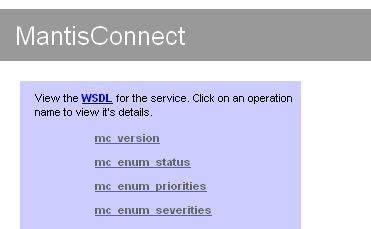

if you enter http://server/mantis/api/soap/mantisconnect.php in the browser, is there a page like the following shown?
AFAIK this is not needed.

Hello Torsten,
I receive exactly that kind of page, yes.
Regards.
Christoph
