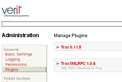

Just for the record (and as a checklist for others having problems with Trac): I assume you did install the XML-RPC Plugin in Trac, and it is showing up in Trac as follows:
Next part would be to check that the XMLRPC-Plugin actually works with NTML Authentication.
It is possible that:
a) This combination does not work at all (in Trac)
b) On the Klaros side the connector automatically tries the user credentials of the account it is running in
This currently only ensures that a connection can be established to that URL.
Please send the relevant parts of the Klaros and Trac log files to support@verit.de.

We definitely have the plugin in place and working as we use it for another tool also.
I just emailed some screen shots to the support email address as I thought they might come in handy
We seem to be on TRAC 0.12

Thanks to you and your team for your efforts on this one.
Torsten Stolpmann, modified 15 Years ago.
RE: TRAC Integration help
You see me relieved
Does that mean Trac-NTML Authentication is also working now?
Jamie Gagnon, modified 15 Years ago.
Padawan Posts: 46 Join Date: 8/27/10 Recent Posts
Unfortunately Unable to test that for you. I only have community version.
What I can do as a form of test would be to set a user up in community that is an exact match to my TRAC NTLM user account.
Otehr than that, I am afraid I cannot do. Will come back to you shortly
Well the good news it if it works it should work with the community edition as well.
Looking forward to your feedback!
Ok tested by creating a user to be the exact same as my NTLM user.
Authentication with TRAC worked without asking for username and password again.
Not a clean test of the NTLM feature available in Enterprise though. Any plans to have such a facility available in Community version?
We will have to look into this. Generally spoken, new features are driven by customer demands.
I will get back to you via PM.
