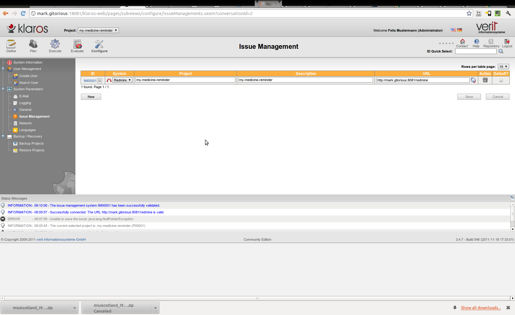

Julius Ræstad, modified 14 Years ago.
RE: Error when create an issue in Redmine
Youngling Posts: 3 Join Date: 3/29/11 Recent Posts
We are having a simular problem.
This is our environment;
Klaros v3.3.2 - Build 967
Redmine v1.1.2.stable
Mylyn v2.7.1.stable
When we try to create an issue we get a java.lang.NullPointerException in the log. The issue is created in Redmine, but there is no link in Klaros to the issue when looking in the "Issues by test case" view.

I am also experiencing a problem with the integration. I successfully validated the credentials and tried to Create an Issue. Upon creating, it produces 2 Issues in Redmine as you can see in one of my attached files. But then the response in Klaros is NPE. I set this up in a VM using Redmine 1.2.2.stable (MySQL) BitNami stack and added Mylyn Connector plugin 2.7.5.stable. This was also setup using openjdk-6 and openjdk-7 under ubuntu server 11.10.
What could possibly the problem? Is there something I can do to help out like check the source code? Do I need to install oracle-jdk7? I really liked how this app was designed and I am proposing this to the company I'm with. I hope you could help me out with the Redmine Integration as this is one of the Key selling points I am looking at.
Many Thanks!
Mark
Many Thanks!
Mark

Just currently tested with oracle-jdk-7 same NPE.
Dec 09, 2011 9:28:54 AM com.sun.faces.lifecycle.RenderResponsePhase execute | |
INFO: WARNING: FacesMessage(s) have been enqueued, but may not have been displayed. | |
sourceId=null[severity=(INFO 0), summary=(Welcome, admin), detail=(Welcome, admin)] | |
2011-12-09 09:30:47: ERROR, de.verit.klaros.web.beans.pages.execute.IssueBean, http-18081-5 | |
de.verit.klaros.service.issuemanagement.IssueManagementException: java.lang.NullPointerException | |
at de.verit.klaros.service.issuemanagement.mylyn.redmine.RedmineIssueManagementService.storeIssue(RedmineIssueManagementService.java:244) ~[klaros-mylyn-3.4.7.jar:3.4.7] | |
at de.verit.klaros.service.issuemanagement.mylyn.MylynIssueManagementService.createIssue(MylynIssueManagementService.java:256) ~[klaros-mylyn-3.4.7.jar:3.4.7] | |
at de.verit.klaros.service.issuemanagement.connection.IssueManagementConnectionImpl.createIssue(IssueManagementConnectionImpl.java:234) ~[klaros-mylyn-3.4.7.jar:3.4.7] | |
at de.verit.klaros.web.service.issuemanagement.IssueManagementPersistentService.saveIssue(IssueManagementPersistentService.java:267) ~[IssueManagementPersistentService.class:na] | |
at sun.reflect.NativeMethodAccessorImpl.invoke0(Native Method) ~[na:1.7.0] | |
at sun.reflect.NativeMethodAccessorImpl.invoke(NativeMethodAccessorImpl.java:57) ~[na:1.7.0] | |
at sun.reflect.DelegatingMethodAccessorImpl.invoke(DelegatingMethodAccessorImpl.java:43) ~[na:1.7.0] | |
at java.lang.reflect.Method.invoke(Method.java:601) ~[na:1.7.0] | |
at org.jboss.seam.util.Reflections.invoke(Reflections.java:22) [jboss-seam-2.2.2.Final.jar:2.2.2.Final] | |
at org.jboss.seam.intercept.RootInvocationContext.proceed(RootInvocationContext.java:32) [jboss-seam-2.2.2.Final.jar:2.2.2.Final] | |
at org.jboss.seam.intercept.SeamInvocationContext.proceed(SeamInvocationContext.java:56) [jboss-seam-2.2.2.Final.jar:2.2.2.Final] | |
at org.jboss.seam.transaction.RollbackInterceptor.aroundInvoke(RollbackInterceptor.java:28) [jboss-seam-2.2.2.Final.jar:2.2.2.Final] | |
at org.jboss.seam.intercept.SeamInvocationContext.proceed(SeamInvocationContext.java:68) [jboss-seam-2.2.2.Final.jar:2.2.2.Final] | |
at org.jboss.seam.core.BijectionInterceptor.aroundInvoke(BijectionInterceptor.java:77) [jboss-seam-2.2.2.Final.jar:2.2.2.Final] | |
at org.jboss.seam.core.MethodContextInterceptor.aroundInvoke(MethodContextInterceptor.java:44) [jboss-seam-2.2.2.Final.jar:2.2.2.Final] | |
at org.jboss.seam.core.SynchronizationInterceptor.aroundInvoke(SynchronizationInterceptor.java:32) [jboss-seam-2.2.2.Final.jar:2.2.2.Final] | |
at org.jboss.seam.intercept.RootInterceptor.invoke(RootInterceptor.java:107) [jboss-seam-2.2.2.Final.jar:2.2.2.Final] | |
at org.jboss.seam.intercept.JavaBeanInterceptor.interceptInvocation(JavaBeanInterceptor.java:185) [jboss-seam-2.2.2.Final.jar:2.2.2.Final] | |
at org.jboss.seam.intercept.JavaBeanInterceptor.invoke(JavaBeanInterceptor.java:103) [jboss-seam-2.2.2.Final.jar:2.2.2.Final] | |
at de.verit.klaros.web.service.issuemanagement.IssueManagementPersistentService_$$_javassist_seam_82.saveIssue(IssueManagementPersistentService_$$_javassist_seam_82.java) ~[IssueManagementPersistentService.class:na] | |
at de.verit.klaros.web.beans.pages.execute.IssueBean.saveIssue(IssueBean.java:464) ~[IssueBean.class:na] | |
at de.verit.klaros.web.beans.pages.execute.IssueBean_$$_javassist_seam_81.saveIssue(IssueBean_$$_javassist_seam_81.java) [IssueBean.class:na] | |
at org.jboss.el.util.ReflectionUtil.invokeMethod(ReflectionUtil.java:335) [jboss-el-1.0_02.CR5.jar:1.0_02.CR5] | |
at org.jboss.el.util.ReflectionUtil.invokeMethod(ReflectionUtil.java:348) [jboss-el-1.0_02.CR5.jar:1.0_02.CR5] | |
at org.jboss.el.parser.AstPropertySuffix.invoke(AstPropertySuffix.java:58) [jboss-el-1.0_02.CR5.jar:1.0_02.CR5] | |
at org.jboss.el.parser.AstValue.invoke(AstValue.java:96) [jboss-el-1.0_02.CR5.jar:1.0_02.CR5] | |
at org.jboss.el.MethodExpressionImpl.invoke(MethodExpressionImpl.java:276) [jboss-el-1.0_02.CR5.jar:1.0_02.CR5] | |
at com.sun.facelets.el.TagMethodExpression.invoke(TagMethodExpression.java:68) [icefaces-facelets-1.8.2.jar:na] | |
at javax.faces.component.MethodBindingMethodExpressionAdapter.invoke(MethodBindingMethodExpressionAdapter.java:88) [jsf-api-1.2_14.jar:1.2_14-b01-FCS] | |
at com.sun.faces.application.ActionListenerImpl.processAction(ActionListenerImpl.java:102) [jsf-impl-1.2_14.jar:1.2_14-b01-FCS] | |
at javax.faces.component.UICommand.broadcast(UICommand.java:387) [jsf-api-1.2_14.jar:1.2_14-b01-FCS] | |
at javax.faces.component.UIViewRoot.broadcastEvents(UIViewRoot.java:475) [jsf-api-1.2_14.jar:1.2_14-b01-FCS] | |
at javax.faces.component.UIViewRoot.processApplication(UIViewRoot.java:756) [jsf-api-1.2_14.jar:1.2_14-b01-FCS] | |
at com.sun.faces.lifecycle.InvokeApplicationPhase.execute(InvokeApplicationPhase.java:82) [jsf-impl-1.2_14.jar:1.2_14-b01-FCS] | |
at com.sun.faces.lifecycle.Phase.doPhase(Phase.java:100) [jsf-impl-1.2_14.jar:1.2_14-b01-FCS] | |
at com.sun.faces.lifecycle.LifecycleImpl.execute(LifecycleImpl.java:118) [jsf-impl-1.2_14.jar:1.2_14-b01-FCS] | |
at de.verit.klaros.web.beans.application.lifecycle.LifecycleImpl.execute(LifecycleImpl.java:54) [LifecycleImpl.class:na] | |
at com.icesoft.faces.webapp.http.core.JsfLifecycleExecutor.apply(JsfLifecycleExecutor.java:18) [icefaces-1.8.2-1.jar:na] | |
at com.icesoft.faces.webapp.http.core.ReceiveSendUpdates.renderCycle(ReceiveSendUpdates.java:132) [icefaces-1.8.2-1.jar:na] | |
at com.icesoft.faces.webapp.http.core.ReceiveSendUpdates.service(ReceiveSendUpdates.java:74) [icefaces-1.8.2-1.jar:na] | |
at com.icesoft.faces.webapp.http.core.RequestVerifier.service(RequestVerifier.java:31) [icefaces-1.8.2-1.jar:na] | |
at com.icesoft.faces.webapp.http.common.standard.PathDispatcherServer.service(PathDispatcherServer.java:24) [icefaces-1.8.2-1.jar:na] | |
at com.icesoft.faces.webapp.http.servlet.BasicAdaptingServlet.service(BasicAdaptingServlet.java:16) [icefaces-1.8.2-1.jar:na] | |
at com.icesoft.faces.webapp.http.servlet.PathDispatcher.service(PathDispatcher.java:23) [icefaces-1.8.2-1.jar:na] | |
at com.icesoft.faces.webapp.http.servlet.SessionDispatcher.service(SessionDispatcher.java:53) [icefaces-1.8.2-1.jar:na] | |
at com.icesoft.faces.webapp.http.servlet.SessionVerifier.service(SessionVerifier.java:26) [icefaces-1.8.2-1.jar:na] | |
at com.icesoft.faces.webapp.http.servlet.MainServlet.service(MainServlet.java:131) [icefaces-1.8.2-1.jar:na] | |
at javax.servlet.http.HttpServlet.service(HttpServlet.java) [servlet-api.jar:na] | |
at de.verit.klaros.web.servlet.ExceptionHandlingPersistentFacesServlet.service(ExceptionHandlingPersistentFacesServlet.java:51) [ExceptionHandlingPersistentFacesServlet.class:na] | |
at com.icesoft.faces.webapp.xmlhttp.BlockingServlet.service(BlockingServlet.java:56) [icefaces-1.8.2-1.jar:na] | |
at org.apache.catalina.core.ApplicationFilterChain.internalDoFilter(ApplicationFilterChain.java) [catalina.jar:6.0.33] | |
at org.apache.catalina.core.ApplicationFilterChain.doFilter(ApplicationFilterChain.java) [catalina.jar:6.0.33] | |
at org.apache.catalina.core.StandardWrapperValve.invoke(StandardWrapperValve.java) [catalina.jar:6.0.33] | |
at org.apache.catalina.core.StandardContextValve.invoke(StandardContextValve.java) [catalina.jar:6.0.33] | |
at org.apache.catalina.core.StandardHostValve.invoke(StandardHostValve.java) [catalina.jar:6.0.33] | |
at org.apache.catalina.valves.ErrorReportValve.invoke(ErrorReportValve.java) [catalina.jar:6.0.33] | |
at org.apache.catalina.core.StandardEngineValve.invoke(StandardEngineValve.java) [catalina.jar:6.0.33] | |
at org.apache.catalina.connector.CoyoteAdapter.service(CoyoteAdapter.java) [catalina.jar:6.0.33] | |
at org.apache.coyote.http11.Http11Processor.process(Http11Processor.java) [tomcat-coyote.jar:6.0.33] | |
at org.apache.coyote.http11.Http11Protocol$Http11ConnectionHandler.process(Http11Protocol.java) [tomcat-coyote.jar:6.0.33] | |
at org.apache.tomcat.util.net.JIoEndpoint$Worker.run(JIoEndpoint.java) [tomcat-coyote.jar:6.0.33] | |
at java.lang.Thread.run(Thread.java:722) [na:1.7.0] | |
Caused by: java.lang.NullPointerException: null | |
at net.sf.redmine_mylyn.internal.core.client.Client.createIssue(Client.java:121) ~[mylyn-core-0.2.0.201103230840.jar:na] | |
at net.sf.redmine_mylyn.core.KlarosRedmineTaskDataHandler.postTaskData(KlarosRedmineTaskDataHandler.java:154) ~[klaros-mylyn-3.4.7.jar:3.4.7] | |
at de.verit.klaros.service.issuemanagement.mylyn.redmine.RedmineIssueManagementService.storeIssue(RedmineIssueManagementService.java:237) ~[klaros-mylyn-3.4.7.jar:3.4.7] | |
... 87 common frames omitted |
