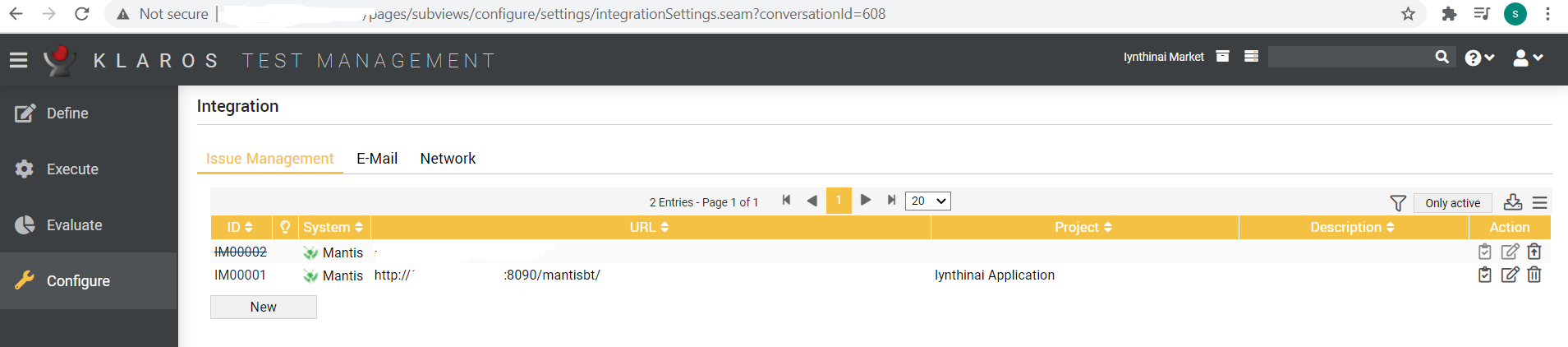

Attached the screenshot of the config. I just entered /mantisbt/ only in the configuration.

Hi Selva,
This basically looks ok to me.
Do you also receive a 404 if you remove the trailing slash in your URL?

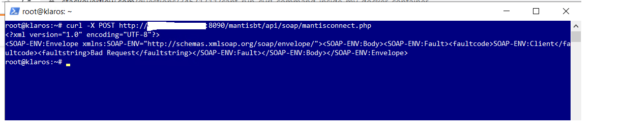

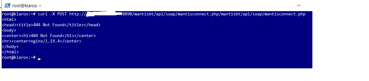

I have installed CURL inside Klaros docker and tried to issue the POST from Curl. Attached the screen shot.
I am getting SOAP response with correct url.
With duplicated URL, it is giving 404 error.
I have attached both the screen shots.

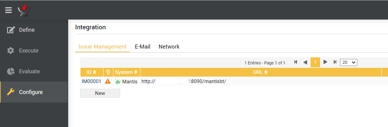

Attached the config screenshot.
[30/Nov/2020:16:08:18 +0000] "POST /mantisbt/api/soap/mantisconnect.php/api/soap/mantisconnect.php HTTP/1.1" 404 153 "-" "Mylyn Mylyn-Mantis Connector/Version n/a Apache Axis/1.4 HttpClient/3.1 Java/11.0.9 (AdoptOpenJDK) Linux/4.9.184-linuxkit (amd64)"
