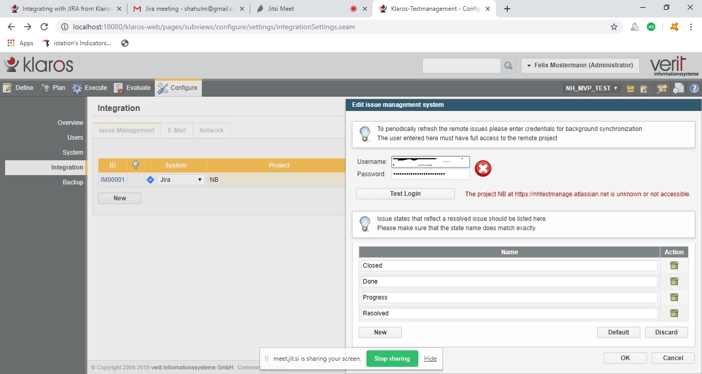

Hello ,
I have installed the Klaros Testmanageent Commuity Edition and trying to test integrating the JIRA for bug tracking and reporting. We are facing issue Integrating the JIRA with Klaros. We have created the API token in JIRA and have been using that token to authenticate the JIRA Cloud instance for our testing . It is failing to authenticate and integrate with JIRA.
When I tried test that Token using Postman , it is able to connect and authenticate. Below is the error in the log that we got :
2020-01-26 16:07:49: ERROR, de.verit.klaros.web.handler.GlobalExternalConnectionHandler, http-nio-18080-exec-4 Unable to connect to external server IM00001 at https://nhbraintest.atlassian.net/
de.verit.klaros.exception.KlarosServiceException: RestClientException{statusCode=Optional.of(403), errorCollections=[]}
Appreciate any help ..

Hello Shalul,
from the stacktrace it seems that you configured the Jira Legacy server type for connecting to your Jira Cloud instance.
This will not work, as it uses the SOAP interface for which support has been dropped by Atlassian a long time ago.
Please change your IMS server type to Jira and try again.

Thanks Tortan for your immediate reply ..
I am setting up for JIRA by choosing the system as Jira .. I am not actually selecting the Jira Legacy option . By selecting the System as Jira, I am giving the User ID as my mail User id and the API Token as the password . Attached the screen shot for reference. It says sometimes the PROJECT does not exist or sometimes the Null pointer excetion . It is not actually authenticating and getting integrated. Please find attached the screen shot for the reference.
Shahul
Shahul

Hello Shahul,
thanks for your follow-up, we were able to reproduce this issue.
Apparently the behavior of the Jira instance has changed slightly (now sending a 403 instead of 401) during our connection check.
This issue is tracked under the ID KLAROS-4305. We will cover it in the 4.12.5 release later this week.
I will let you know as soon as it is ready.
Thank you for reporting!

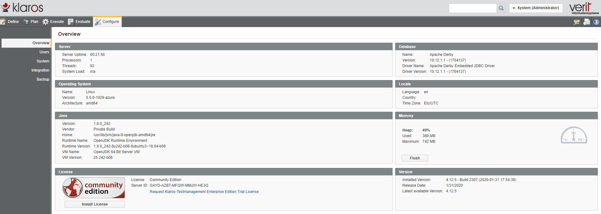

thanks for the logs which contained the following valuable information:
05-Feb-2020 13:12:02.008 INFO org.apache.catalina.startup.VersionLoggerListener.log Java Home: C:\Program Files\Java\jdk-9.0.1
05-Feb-2020 13:12:02.008 INFO org.apache.catalina.startup.VersionLoggerListener.log JVM Version: 9.0.1+11
Java 9 is not supported as stated in the installation manual here:
https://www.klaros-testmanagement.com/files/doc/html/User-Manual.Installation.html#User-Manual.Installation.Prerequisites.Server
We also added a notification for this on the Configure / Overview page which you probably missed.
Please revert your Java-Installation to Java 8. I think this should fix your problem, but please let us know anyway.
As you are running Klaros under Windows without installing it as a service, some log messages will be sent to the console window only.
Please switch to a Windows service installation as described here:
https://www.klaros-testmanagement.com/files/doc/html/User-Manual.Installation.html#User-Manual.Installation.installAsService.Windows
This allows for easier identification of any problems you might have.
The .klaros folder Fabian mentioned will is created in the home folder of the user starting klaros. You find an exhaustive list in the documentation here:
https://www.klaros-testmanagement.com/files/doc/html/User-Manual.Installation.html#User-Manual.Installation-Process.Main.Important-Files

I`ve used the Windows machine just to try it from one more point. The main idea is that Klaros TMS will be hosted on a VM in the cloud and the VM will be a Linux one. I`ve tried what you suggested (thanks for the tip for the Java version, I did really miss that!) but unfortunately it didn`t work. Here is the overview of the Ubuntu server:
Ibraim
Ibraim

Youngling Posts: 6 Join Date: 1/30/20 Recent Posts
It is working fine now as well. It turns out that I was trying to access it using the project Name, rather than project Key (another forum topic). Maybe the error message that is returning should change a bit to lead to Project Name/ Key check and not only to Unauthenticated error which in this case is misleading. Thank you all for the support!
Ibraim
Ibraim
Torsten Stolpmann, modified 5 Years ago.
RE: Integrating with JIRA from Klaros Community Edition (Answer)
Jedi Council Member Posts: 775 Join Date: 2/12/09 Recent Posts
Hi Ibrahim,
thanks for the update, I am glad to hear that this is resolved for you.
We implemented KLAROS-4316 today, which is adding a log entry in the form of:
This improvement will be available with the next released version.
Thank you for your suggestion and feel free to add!
Kind regards,
Unexpected error: 'Support' is not a valid project key, did you mean 'SUP'?
