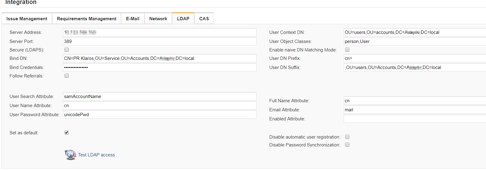

Torsten Stolpmann, modified 6 Years ago.
RE: 2012 Active Directory Integration (Answer)
As a working solution may be of interest to others as well, here is a working configuration for AD 2012.
