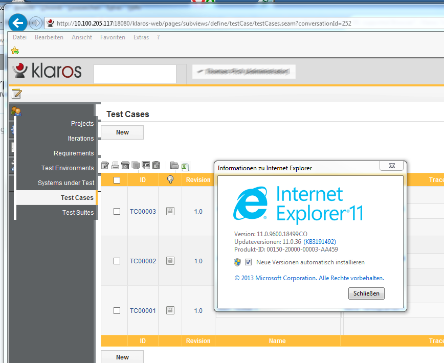

the rendering of a local installation of Klaros 4.5.5 - Build 847 (2016-09-09 17:19:07) looks fine in Firefox 49.0.2 and incorrect in Internet Explorer 11. (see the attachement pls). The rendering of your remote demo site looks nice in IE and FF. I'm behind a proxy. There are broken links to external css files or similar?

since you were cutting off the right hand part of the sccreenshot I cannot confirm this 100% but I think your browser has activated quirks mode for intranet pages.

thanks for your fast response. Yes, it works for me. From IE I switched off Tools>Compatibility View Settings and unchecked "Display Intranet Sites in Compatibility View".
