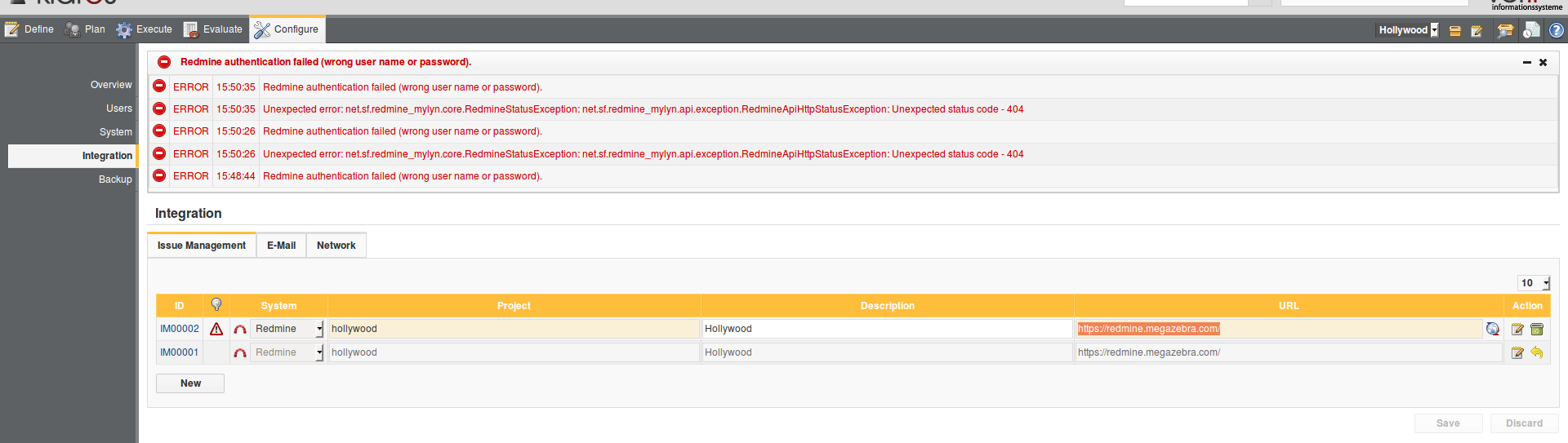

Torsten Stolpmann, modified 9 Years ago.
RE: Redmine Integration
Hi Tatjana,
can you please add a screenshot of the Klaros issue management system entry?
Tatiana Burak, modified 9 Years ago.
Youngling Posts: 4 Join Date: 10/21/16 Recent PostsTorsten Stolpmann, modified 9 Years ago.
Yes, looks ok for me.
I really suspect the plugin fork you are using.
Cheers,
Cheers,
