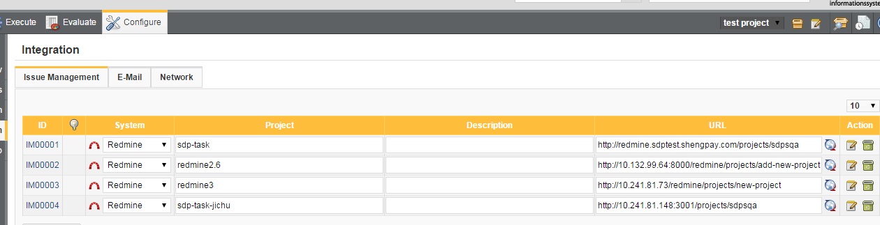

The Server at URL http://10.241.81.148:3001/projects/sdpsqa could not be contacted: net.sf.redmine_mylyn.api.exception.RedmineApiHttpStatusException: Unexpected status code - 404
Redmine 2.5.2 stable
According to the document,have configed the mylyn plugin and the Redmine settings.

I suspect that you have entered the wrong URL for your your redmine server, you must not include the path to your project there.
So it should probably look like shown below:
URL: http://10.132.99.64
Project: sdpsqa
Does this resolve your problem?
Project: sdpsqa

Please drop the /projects/xxxx part from your URL.

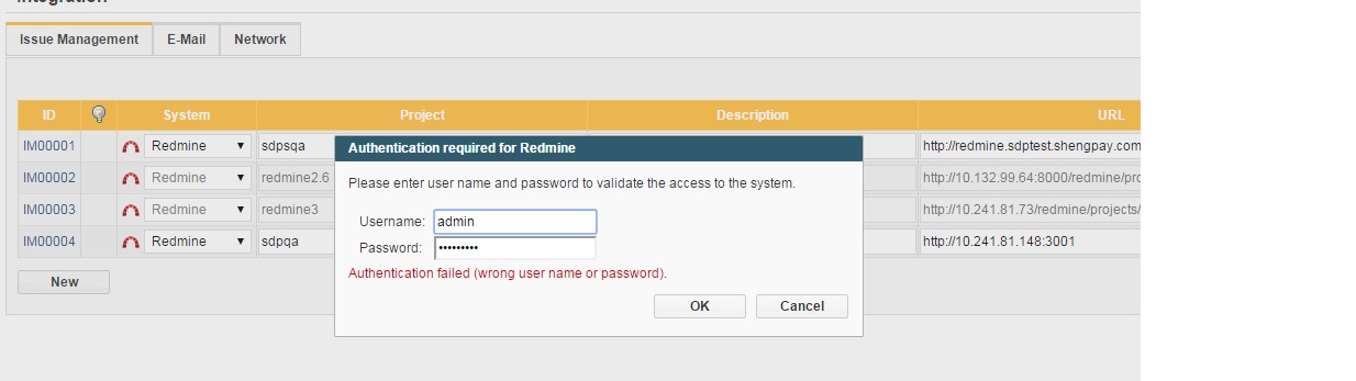

Got it.Sorry for my carelessness.
But seems i met a new issue,the authentication always like this,i confirmed the user name and password.

Please add the klaros logs.
