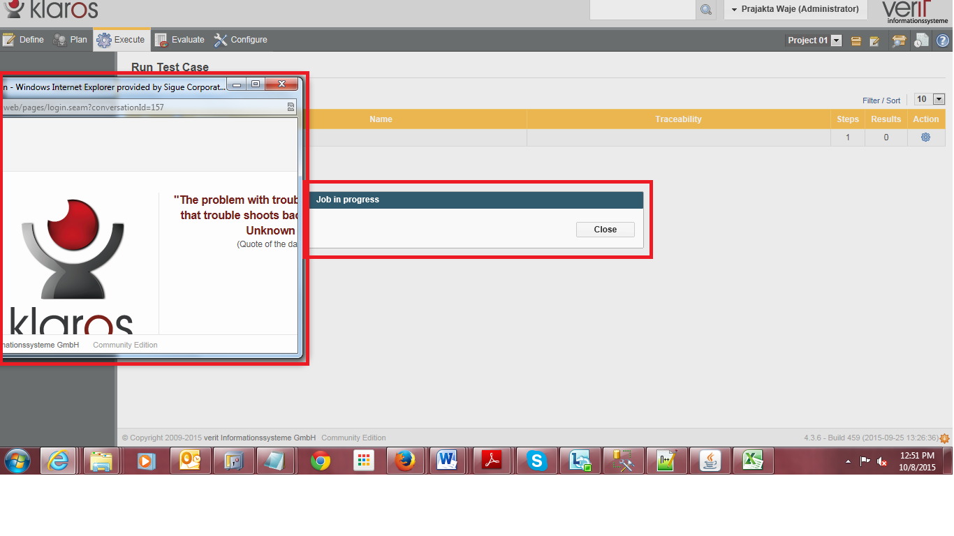

I have klaros 4.3.6 installed in my PC.
I have created test cases and set test environment as well. When I click on Test case execute button it is getting redirected to login page of klaros and one blank pop up window saying 'Job in Progress' appears on the same page.
Please find the attached screenshot.

Hi Prajakta,
may I ask if your installation is running behind a proxy server? If so, the URL of the application needs to be entered in 'Configure/System/Application URL'. That URL needs to match the URL you see in your browsers address bar.

Yes, my application is running behind proxy server (Tomcat). I have already entered url 'http://192.168.56.1:18080/klaros-web/pages/login.seam' in 'Configure/System/Application URL'. And I am using the same url for klaros. But still I am getting this error.

Hi again,
Removing the adhered '/pages/login.seam' from the URL should do the trick (--> http://192.168.56.1:18080/klaros-web)

Thank you very much for this great help. Now I am able to excecute test cases and also I am able to export reports as well.
