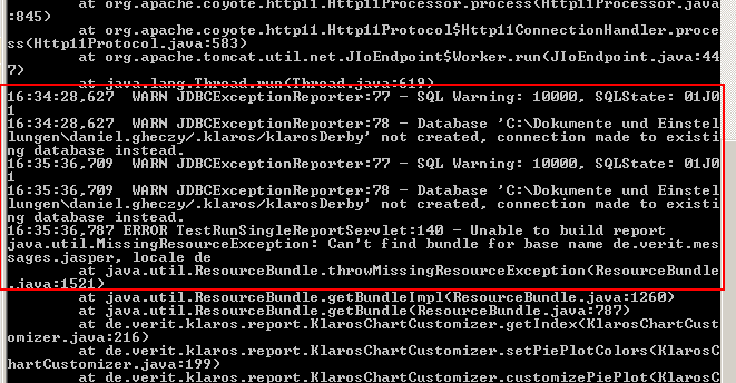

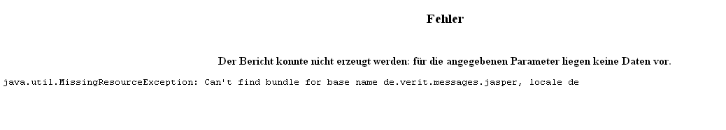

I can't create single test run reports and am redirected to an error page, see first screenshot. In the second screenshot you can see the section of the tomcat window where I think the error occurs.

thanks for the report. Can you please send us your tomcat logfiles to support@verit.de? Are other reports affected as well? Does the error persist after a tomcat restart?

Thanks for the log files. We will release the Version 2.3.3 later today that will contain a fix for this issue (KLAROS-587).

the 2.3.3 Release is now available, can you please check if that solves your problem?

if installed 2.3.3 with a Postresql-DB now and everything seems to work so far. Thanks!!!
