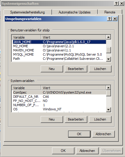

please make sure that you have JAVA_HOME defined in your environment settings as shown in the picture attached and start the Klaros-Testmanagement Server. I am unsure why the Java-Installer did not set this automatically.

We've installed the JDK and set the JAVA_HOME variable like you said. Now the Tomcat starts and the last line says: "INFO: Startup in 78ms". But when I try to connect to Klaros-Testmanagement the page just keeps loading forever.
So I took a closer look to the Tomcat-Window and there where some Errors during the starting procedure. I tried to attach the log files but i received a message telling me that it doesn't like the file format, so I change the extension from .log to .txt.
