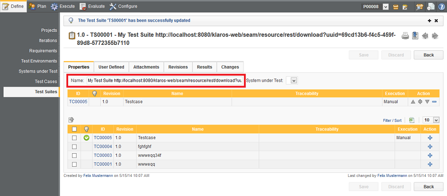

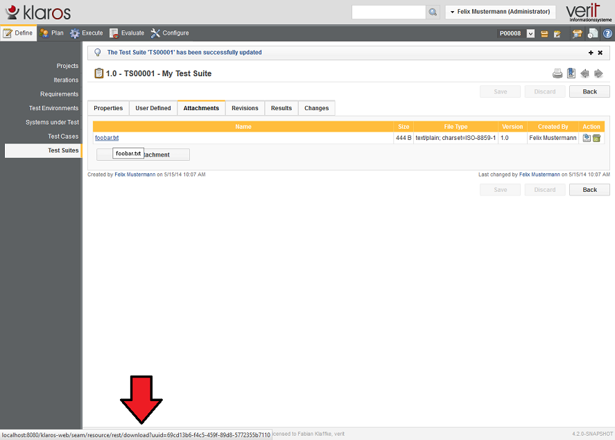

1) Copy the link of the test suite attachment from the Attachments tab. (screenshot1.png)
2) Append this link to the Name field of the test suite. (screenshot2.png)

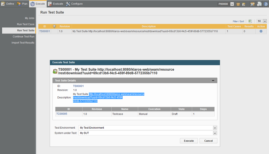

3) Before executing the test suite, you can now copy the link to the attachment from the Description field. This will give you access to the test suite attachment. (screenshot3.png)
