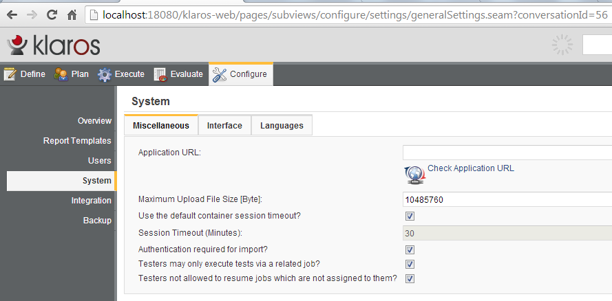

Actually my excel file was done in Excel 2010, for that reason I have .xlsx extension.
I have changed the extension file to .xls. After that I have typed this command:
C:\Users\angel.hidalgo\Documents\Instaladores\Klaros>curl -v -T Formato_TC.xls "http://localhost:18080/klaros-web/seam/resource/rest/import/testcase/xls?config=P000023"
I got this:
Tomcat result:
2014-01-09 08:34:49: ERROR, de.verit.klaros.web.servlet.importer.testcase.XMLTestCaseImportServlet Authentication error - a username and password is required
CMD result:
* Adding handle: conn: 0xb23140
* Adding handle: send: 0
* Adding handle: recv: 0
* Curl_addHandleToPipeline: length: 1
* - Conn 0 (0xb23140) send_pipe: 1, recv_pipe: 0
* About to connect() to localhost port 18080 (#0)
* Trying 127.0.0.1...
* Connected to localhost (127.0.0.1) port 18080 (#0)
> PUT /klaros-web/seam/resource/rest/import/testcase/xls?config=P000023 HTTP/1.1
> User-Agent: curl/7.33.0
> Host: localhost:18080
> Accept: */*
> Content-Length: 30208
> Expect: 100-continue
< HTTP/1.1 100 Continue
< HTTP/1.1 400 Petición incorrecta
* Server Apache-Coyote/1.1 is not blacklisted
< Server: Apache-Coyote/1.1
< Set-Cookie: JSESSIONID=4858CD961A09BB45629E96D8964EDE2C; Path=/klaros-web/; Ht
tpOnly
< Content-Type: */*
< Transfer-Encoding: chunked
< Date: Thu, 09 Jan 2014 13:34:49 GMT
< Connection: close
* we are done reading and this is set to close, stop send
* Closing connection 0
It asked for an authentication, but I don't understand because the project is opened.
Please help me.
Thanks in advance,
Angel Hidalgo

Hi Angel,
Your project is secured against unauthenticated access in your project settings.
You need to provide your username and password to authenticate at the import REST interface. Please refer to http://www.klaros-testmanagement.com/files/doc/html/User-Manual.Import-Export.html#User-Manual.Import-Export.TestResultImport for an example.

I am stuck. My current configuration is showed on the picture attached <System configuration.png>
My user name is a_hidalgo
My password is admin
I saw the help in http://www.klaros-testmanagement.com/files/doc/html/User-Manual.Import-Export.TestResultImport.html
Following the example, I have
C:\Users\angel.hidalgo\Documents\Instaladores\Klaros>curl -v -T Formato_TC.xls "http://localhost:18080/klaros-web/seam/resource/rest/import/testcase/xls?config=P000023&username=a_hidalgo&password=admin"
I got this:
No project configuration found for P000023* Closing connection 0
But my project is opened. what do I need to do??
Thanks in advance,
Angel Hidalgo
