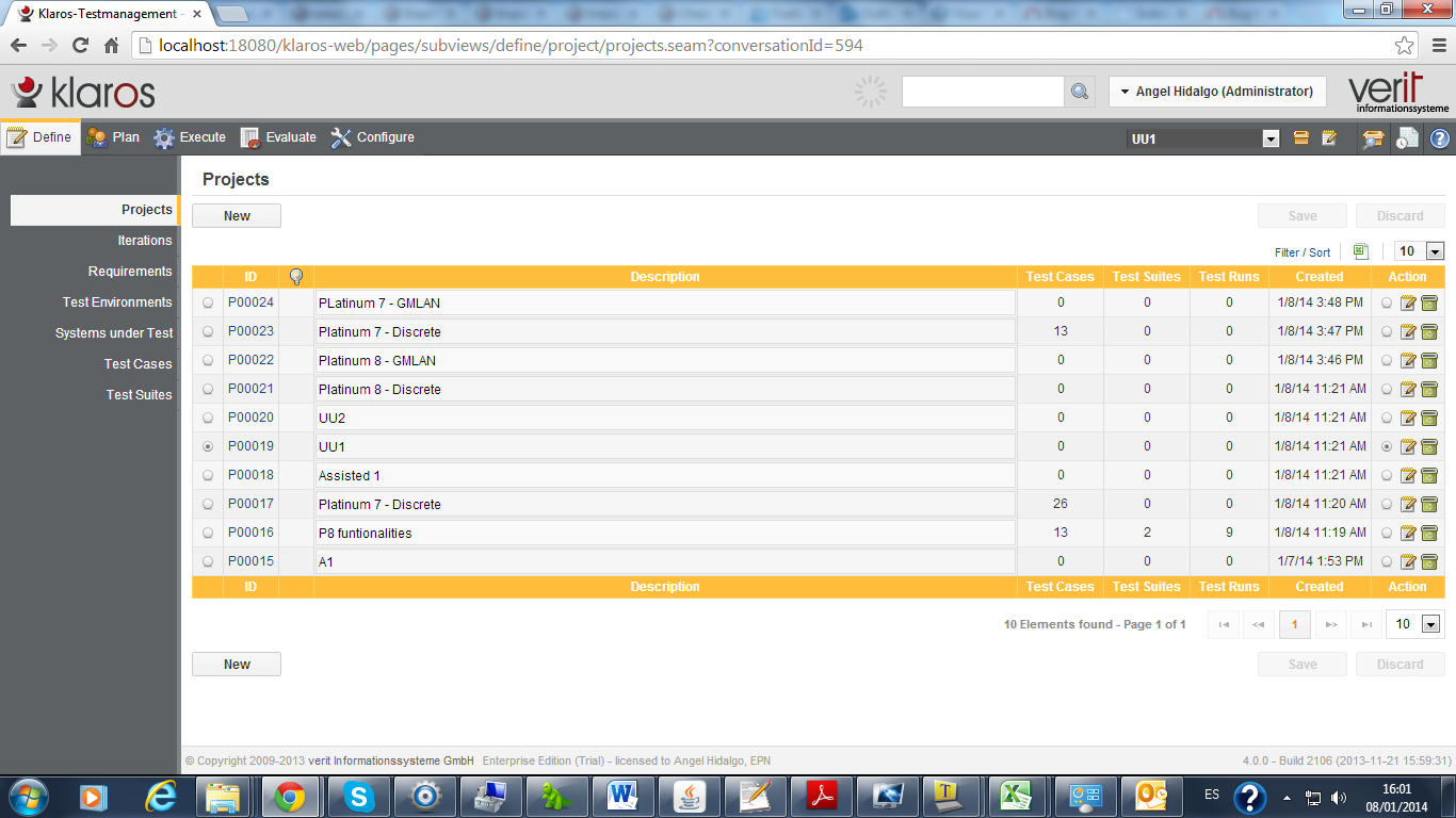

I am testing Klaros, I have created some projects, each of them have their own ID. I want to delete definitely some projects, but I can't. I don't have <Purge icon> in my aplication.

Actually I have installed Klaros in my computer. I got a trial licence of Enterprise version. I enter like Administrator of Klaros, but I don't have <Purge icon>.
I attached an image about it.

Purging a project from the database is a two step process. First, you'll have to delete the project using the delete icon. From then on the project is only visible for administrators, which can then purge the project from the database.
In version 4.0, after deleting a project, it doesn't appear in the list of projects anymore, hence it cannot be purged. This bug has already been fixed for the upcoming release of Klaros-Testmanagement 4.1.
