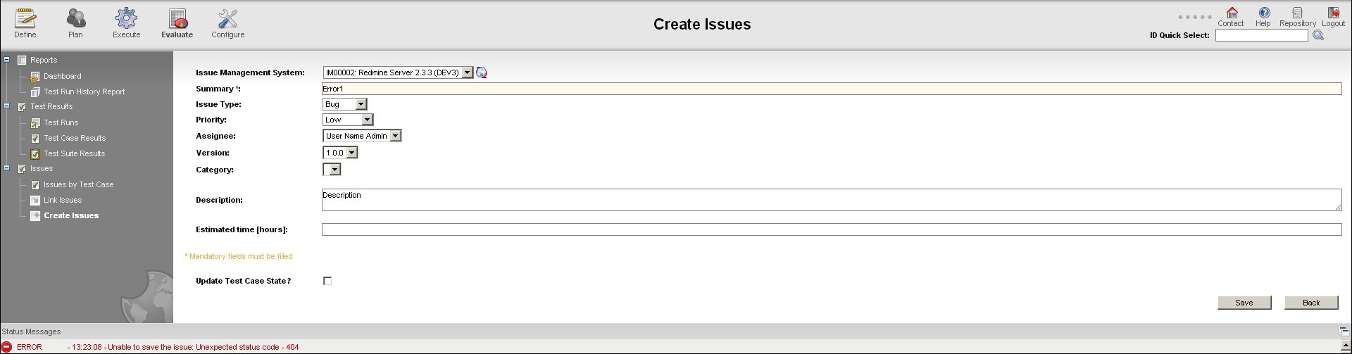

Hello.
I have successfully configured the connection to my local Redmine server and I'm able to fully use the "Link Issues" and "Issues by Test Case functionality". However, when I try to create a new issue, I receive an error (see the attached screenshot).
I suspect that the cause could be in my configuration:
Klaros v3.8.2 + Redmine 2.3.3 / Redmine Redmine-Mylyn-Connector/WS-API Plugin 2.8.2.stable.
I'm aware of the fact, that according to the user manual (3.10.2 Redmine Configuration), this combination (with RM 2.3.3) was not tested but it is expected to work. My Redmine settings are set as instructed = Authentication Required + Enable REST Web Service checkbox checked.
The attached logs from Redmine (the section after clicking the Save button) might help.
They show the "Can't verify CSRF token authenticity" warnings when posting.
What is the problem here?
Could you help me, please?
If the current Redmine 2.3.3 is not supported, do you have some plans for this support?
Thank you.

Thank you for your help, Torsten.
1) Yes. The user is authorized to create issues in the project (role Manager). The issues can be created directly in Redmine.
2) I have added the "config.action_controller.allow_forgery_protection = false" line to config/application.rb. I do not get the CSRF warning anymore.
However, the issue is still present (see the attached part of the log; compared to the old one, it's the same - just without the CSRF warning). It logs "Filter chain halted as :find_project rendered or redirected".
The Redmine project should be set correctly in Klaros.
Do you have any idea?
Could it be some change in the Redmine's REST API when looking up projects or creating issues?
Marian.

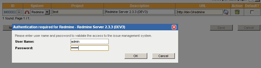

I have double-checked that the URL and project is valid - see attached screenshots.
(I suppose that otherwise the Link Issues functionality would not work ... and it searches the Redmine issues well.)
Marian
Marian

- RM: New Project > name = "Project1" + Identifier = "project1" (Public) > Modules = all > Members = added the user "admin" as role "Manager" > Versions = created "1" (Name) + status "closed" > Issue categories = created "Cat1"
- started and opened Klaros ("admin" user)
- Klaros: Configure > Issue Management > project="project1" + URL="http://dev3/redmine" > Validate URL > admin/pwd > The issue management system IM00002 has been successfully validated.
- Klaros: Evaluate > Create issues > Summary="Issue1" > Save > The issue was successfully created in Redmine with ID 1.

I have backtracked the Redmine project settings (name = "test", version="1.0.0" with status "open", etc.) and it still works.
According to the BitNami changelog for v2.3.3-1, just "Fix SSL support for Subversion on Unix" was added.
So I conclude that my other plugins have causes this issue ... I will check this later if those plugins will be needed to be installed.
Thank you for all your assistance, Torsten.
