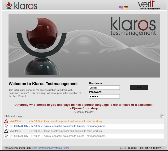

This is very strange and I didn't know how to even title this message. I just installed Klaros on Linux. I got to the Login Screen (in Conqueror) and when I enter the default credentials it error that "Network Connection was interrupted". I click OK and in the Status Message area it tells me I logged in successfully and need to create a project?. A screenshot is attached.

Hi Charles,
this is a known problem with Konqueror's javascript implementation and in fact the reason it is not supported by Klaros-Testmanagement.
The supported browsers are shown in the user manual here.
