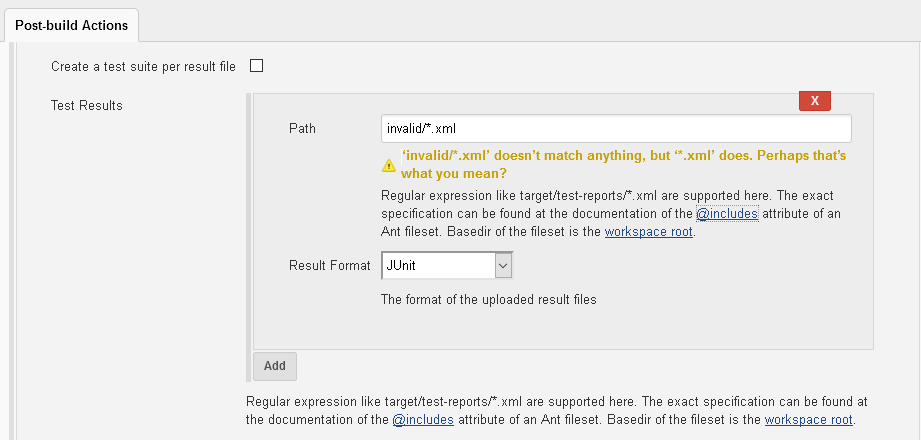

Hi everyone:
I was first to use Klaros Plugin, I have setting all of I could do.
Then, I need to feedback result to Klaros server, and Jenkins Plugin show xml not exist.
So, should I create a xml file to use? or have any reference could help me? thanks a lot.

I assume that you are referring to a situation as shown in the attached screenshot?
The idea is to point the Path to the test result files which your Jenkins job is producing in it's workspace. Typically they are already present from the last build of your Jenkins job. If not you can specify the location regardless of the validation message.

Hi Chen,
sorry, I totally missed out on answering that.
Indeed it is only required to give a path to the result files in your Jenkins job workspace here.
The files to import are constructed by your test automation tool.
