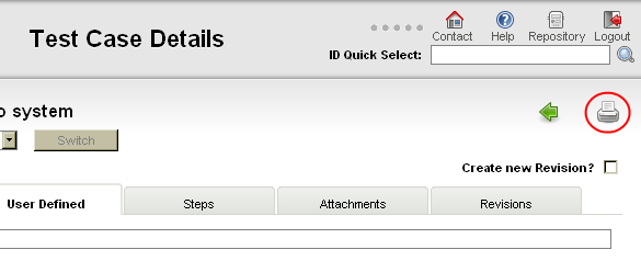

Additionally there is also the print preview link available which renders all this data in a printer friendly way.
Look for the printer icon on the upper right hand side of the test case detail pages. This is also available for test suites and test results and is an Enterprise Edition feature.
