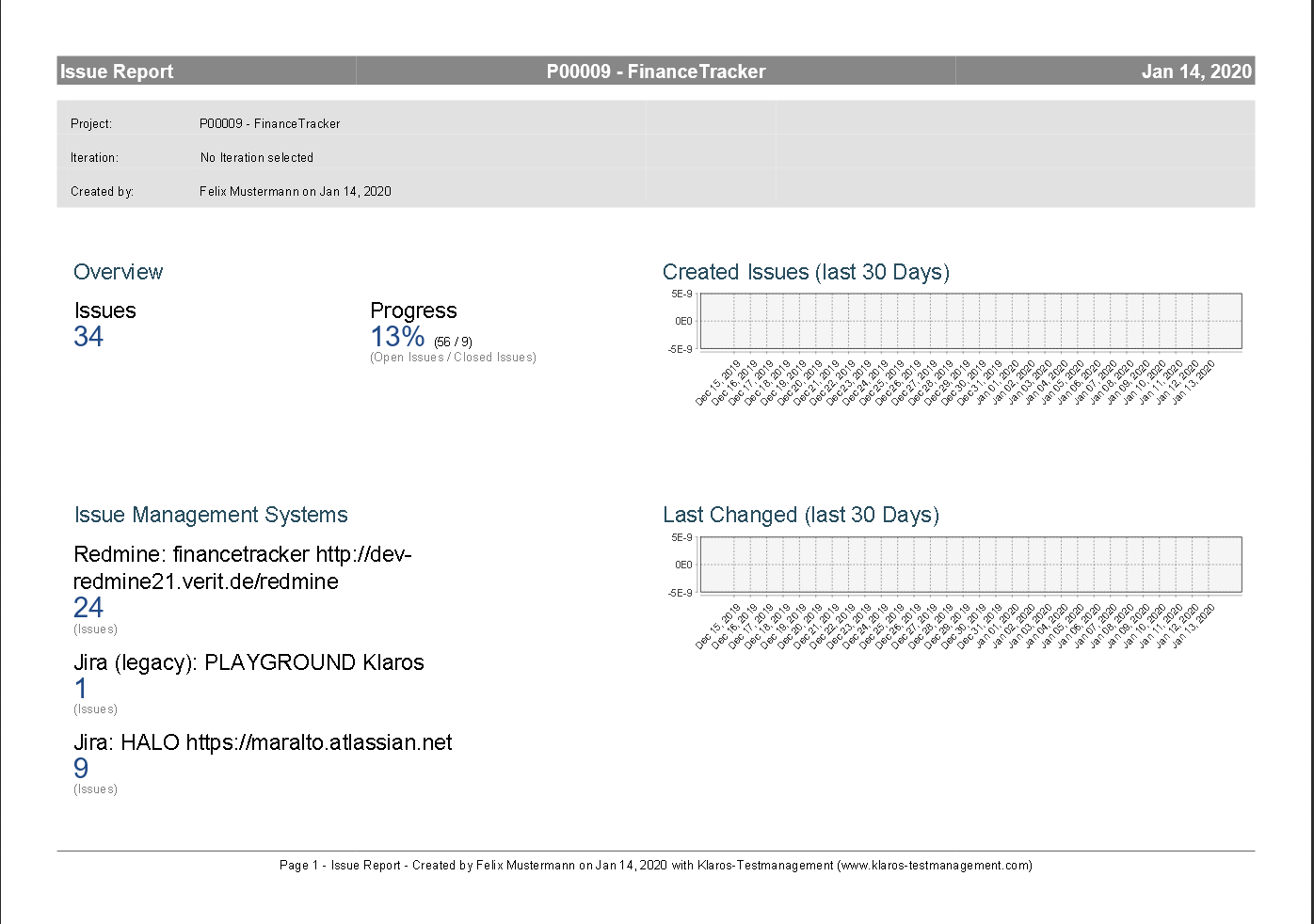

RE: I need Urgent help (Antwort)
Hello Mohamed,
there is already a custom report template available for this purpose, look for Issue Overview Report under Evaluate / Report Templates or Configure / Report Templates.
I hope this satisfies your needs. I f not, you may adapt the template to your requirements. How to do this is described here:
https://www.klaros-testmanagement.com/files/doc/html/User-Manual.CustomReport.html
A detailed tutorial for developing your own templates can be found here: https://www.klaros-testmanagement.com/files/tutorial/html/Report.Tutorial.html
We also offer developing custom report templates as a payed for service if this is of interest to you.
