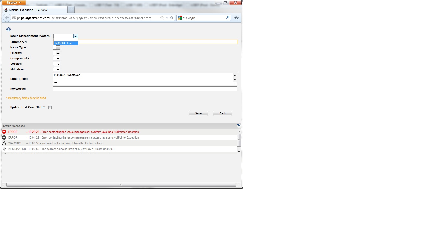

I'm wondering if anyone else has had issues with reporting issues using Trac as the issue management system. I was able to configure Klaros to use Trac and everything seemed to go OK, but I always get a NullPointerException when I try to report an issue using Trac.
I've read the other posts and I've checked to ensure that my XML-RPC permissions are allowed for 'anonymous' with no luck. Unfortunately, I haven't seen anyone else with the same problem in the forum so I'm out of ideas. I've attached server logs and screenshots to help anyone who might have suggestions.

guessing from the stack trace - could it be that you have no versions defined yet in your trac project?

This was the problem but the solution isn't exactly what I was hoping for. The version field was disabled and not used in Trac because it is't a field that we're interested in. (We use a custom text field for build instead). Additionally, the milestone field is a field that we only allow project managers to set. Is it possible to configure Klaros to omit these fields from the submission template?
