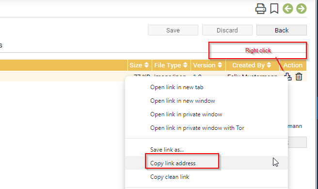

Hello Matthias,
You can link directly to any attachment using the provided download link. You can than add the URL to your test case step action as a link.
Hope this helps, let me know if I can add to this.
