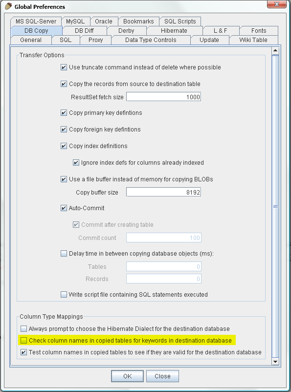

1. Be sure to include the DBCopy plugin upon the installation of SquirrelSQL, as well as the matching database drivers (Derby and target database) from your Klaros distribution (located in <install_dir>/webapps/klaros-web/WEB-INF/lib)
2. Install the driver jars for your databases (using Modify Drivers)
3. Create Aliases for your Databases
4. Change the Global settings for the DBCopy plugin as shown below (disable 'Check Column names in copied tables').
5. Navigate to your source database and select 'Copy Tables' as shown below
6. Paste tables to your target database using 'Paste Tables'
That should do the trick.
this is actually quite simple and well explained in the Squirrel documentation:
