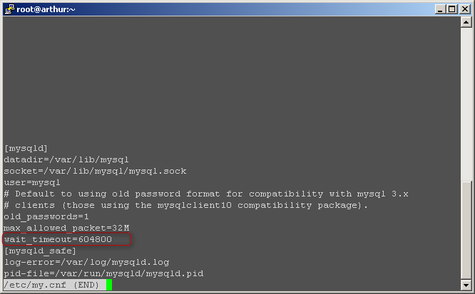

Per default MySQL is closing your open server side connections after 8 hours. These connections will become stale on the client (Klaros) and lead to above error messages.
As a solution we recommend that you configure a bigger timeout in your MySQL Server instance (/etc/mysql.ini) like shown in the attached screenshot. The value shown amounts to 7 days. You have to restart mysql and Klaros afterwards.
