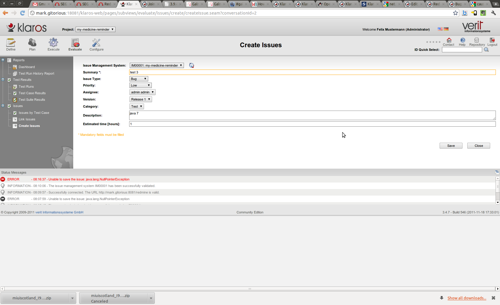

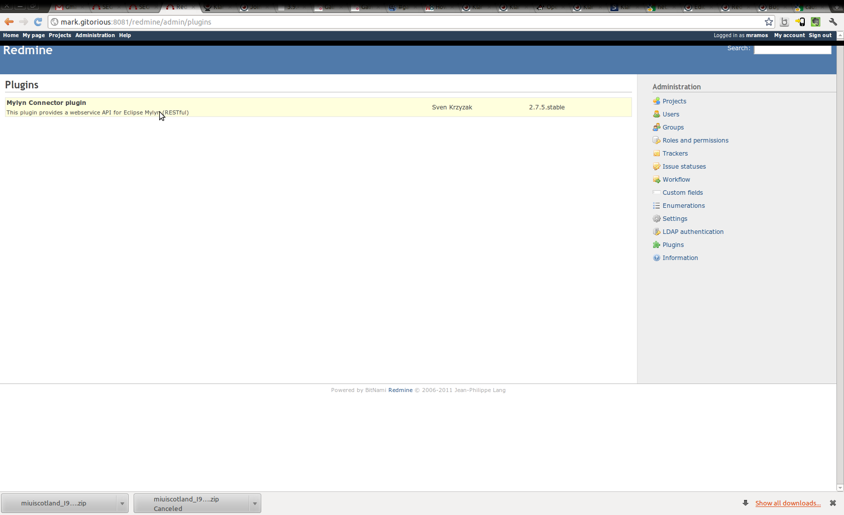

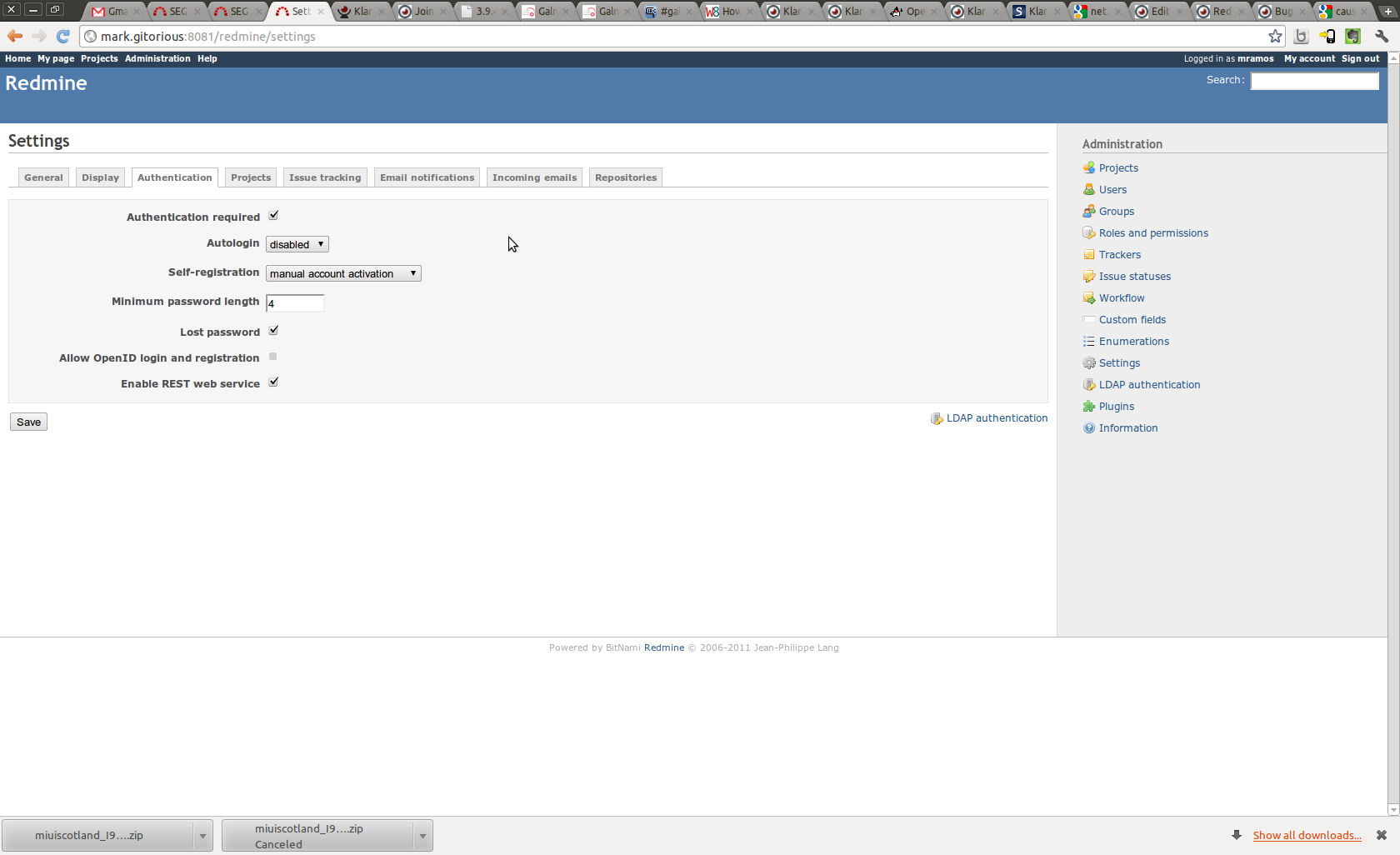

Julius Ræstad, geändert vor 14 Jahren.
RE: Error when create an issue in Redmine
Youngling Beiträge: 3 Beitrittsdatum: 29.03.11 Neueste Beiträge
We are having a simular problem.
This is our environment;
Klaros v3.3.2 - Build 967
Redmine v1.1.2.stable
Mylyn v2.7.1.stable
When we try to create an issue we get a java.lang.NullPointerException in the log. The issue is created in Redmine, but there is no link in Klaros to the issue when looking in the "Issues by test case" view.

did you enable the the Authentication required flag for Redmine as shown in the manual here?

Yes, we have enabled the Authentication flag in Redmine. We also use LDAP integration, may that be a problem?

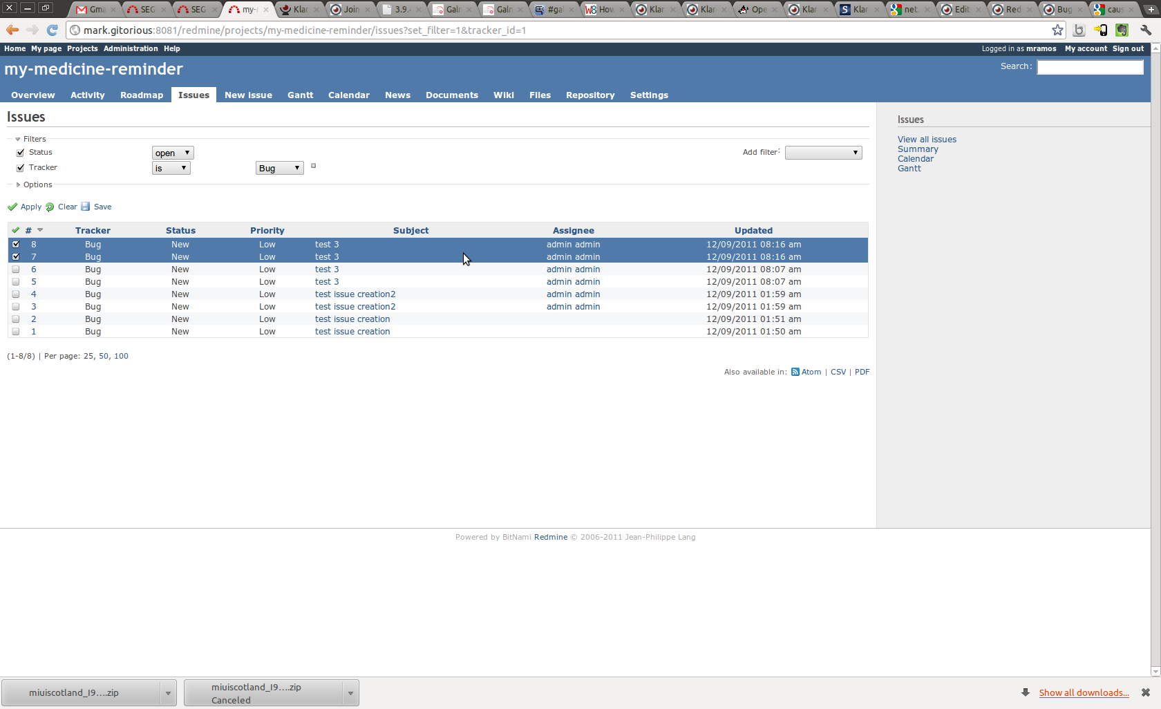

I am also experiencing a problem with the integration. I successfully validated the credentials and tried to Create an Issue. Upon creating, it produces 2 Issues in Redmine as you can see in one of my attached files. But then the response in Klaros is NPE. I set this up in a VM using Redmine 1.2.2.stable (MySQL) BitNami stack and added Mylyn Connector plugin 2.7.5.stable. This was also setup using openjdk-6 and openjdk-7 under ubuntu server 11.10.
What could possibly the problem? Is there something I can do to help out like check the source code? Do I need to install oracle-jdk7? I really liked how this app was designed and I am proposing this to the company I'm with. I hope you could help me out with the Redmine Integration as this is one of the Key selling points I am looking at.

Just currently tested with oracle-jdk-7 same NPE.
Dec 09, 2011 9:28:54 AM com.sun.faces.lifecycle.RenderResponsePhase execute | |
INFO: WARNING: FacesMessage(s) have been enqueued, but may not have been displayed. | |
sourceId=null[severity=(INFO 0), summary=(Welcome, admin), detail=(Welcome, admin)] | |
2011-12-09 09:30:47: ERROR, de.verit.klaros.web.beans.pages.execute.IssueBean, http-18081-5 | |
de.verit.klaros.service.issuemanagement.IssueManagementException: java.lang.NullPointerException | |

Caused by: java.lang.NullPointerException: null | |
at net.sf.redmine_mylyn.internal.core.client.Client.createIssue(Client.java:121) ~[mylyn-core-0.2.0.201103230840.jar:na] | |
at net.sf.redmine_mylyn.core.KlarosRedmineTaskDataHandler.postTaskData(KlarosRedmineTaskDataHandler.java:154) ~[klaros-mylyn-3.4.7.jar:3.4.7] | |
at de.verit.klaros.service.issuemanagement.mylyn.redmine.RedmineIssueManagementService.storeIssue(RedmineIssueManagementService.java:237) ~[klaros-mylyn-3.4.7.jar:3.4.7] | |
... 87 common frames omitted |
