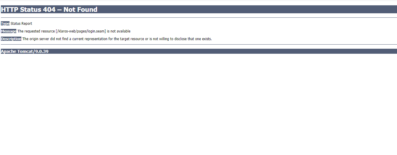

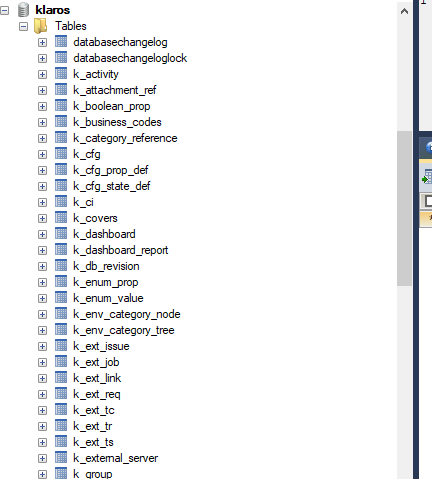

So after changing the DB from Apache to Database to Maria DB by doing changes in hibernate.properties file in /.kalros folder in home directory, new Database in MariaDB is created successfully and all the tables are also created.
but when I accessed the application it throws 404 error.
Files attached are:
Logs file from home directory, DB table snapshot which are created, and 404 error when accessing the application.
Please guide how to fix this issue. I have done everything described in Manual given.
Files attached are:

The dialect is only checked after the inital table creation phase, this is why you can see all tables in your database tool.

I have corrected the typo changes as you said but issue is still the same.
On web interface message is still same "The requested resource [/klaros-web/pages/login.seam] is not available"
I am attaching new log for the refernce.

it looks like the default users have not been created in the k_user table. This is usually done automatically during startup, but it seems to have been skipped due to the false dialect error.
Since it is a fresh database, you can simply try to delete and recreate the database and then start Klaros-Testmanagement again. This will recreate all database tables and should create the default users.
