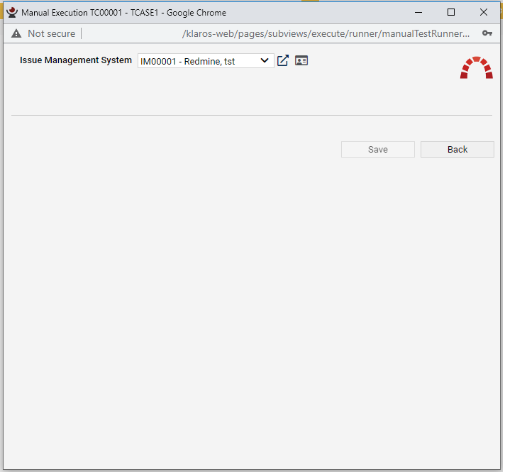

Hi Torsten!
Finnaly I found time to install new 5.0.1 version, but now the issue is, that there are no fields showing.
Link to existing issue works fine.

Caused by: java.lang.NullPointerException: null | |
at de.verit.klaros.service.issuemanagement.redmine.RedmineIssueManagementService.initializeCustomFields(RedmineIssueManagementService.java:599) | |
... 143 common frames omitted |

Hi Victors,
thanks for reporting this.
There is indeed a bug, which only occurs when a custom field is used in several trackers and one of these trackers is not used in the project you are working with.
This should now be fixed via KLAROS-4470 towards 5.0.2.
I appended an updated jar file containing this fix so you are able to verify that this is working for you.
Can you please *replace* the current klaros-mylyn.jar in wepapps/klaros-web/WEB-INF/lib with the one appended and let me know the results after a restart?

Hi Torsten!
It works now, but there is still the original issue. Custom fields are filtered only by tracker, but should be filtered by project also.

So you are seeing custom fields which are present in the tracker definition, but are excluded in the project configuration?
Is this the only issue you have or am I missing something else here?

I am seeing custom fields that are present in tracker definition, but are not excluded in the project definition. In other words there are too many custom fields that should not be there.

Hi Viktors,
I spent some more time with this and sadly I think that we are unable to obtain information about which custom field is enabled or disabled in a given project.
Again, the Remote-API of Redmine is simply not exposing this information to consumers. See this thread: https://www.redmine.org/boards/1/topics/56225
So the best thing we can do at the moment, is limiting the set of custom fields to the selected tracker as we do now.
But if I read the roadmap for Redmine correctly, this may change with the release of Redmine 4.2.0 as this issue seems already resolved here: https://www.redmine.org/issues/33301
Sorry, but this is all we can do at the moment.
