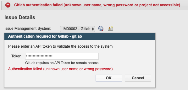

Hello again,
you are right. 3 seconds is to long to wait. but it is better than 30
Thank you for that modified version... but it is still not working. Now I got another issue:
The Authentication is wrong.
I looked into the logs and there is a strange behavior to check if the gitlab server is available.
1. A request is send to: /api/v4/projects/182/issues/2147483647 with an API Token (which is valid).
This is ok, but I'm confused about the issue-id 2147483647. This issue doesn't exists so the server get an 404 not found.
2. Then a second request is send to: /api/v4/user which looks good, BUT there is NO ApiToken in the request. So the Server got an 401 Unauthorized
More requests are not possible because of an exception, that the username/token is invalid, which is not the case.

Torsten Stolpmann, geändert vor 5 Jahren.
RE: Slow Gitlab Integration connection
Jedi Council Member Beiträge: 772 Beitrittsdatum: 12.02.09 Neueste Beiträge
Thanks for the detailed report.
The /api/v4/projects/182/issues/2147483647 request is a probe for validating the connection parameters.
It should only be done once per user session to a Gitlab project and is intentional.
I am unsure about the error message regarding the authentication error you receive, I am going to validate this and get back to you.
