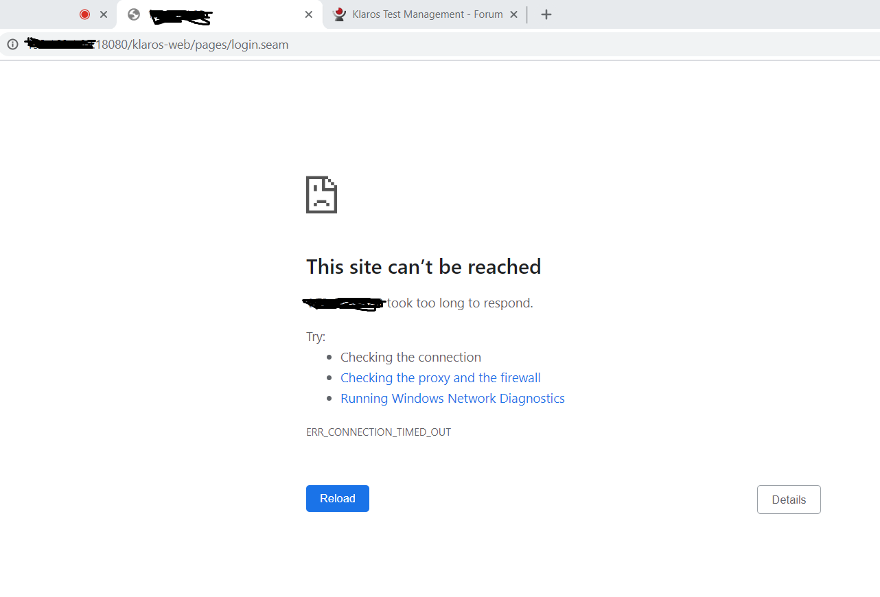

login to the Klaros running on different network using ip address(http://localhost:18080/klaros-web/) replaced local host with ipaddress of the system running on different network, getting below error. Can you please help us here.

Hi Mohamed,
is your Klaros Testmanagement installation running behind a proxy server? If this is the case, then the application URL
needs to be entered in 'Configure/System/Application URL'.
That URL needs to match the URL you see in your browser's address bar.
