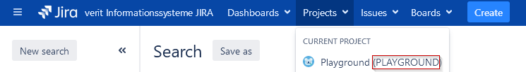

Project is the project id which is showing up in your UI like in the attachment.
