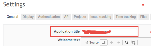

As for the Project ID, I'm not sure if I got this correct because the screenshot on your help file does not match with the Redmine version we're using. I cannot find the 'Identifier' field the help file is pointing out so I used the 'Application Title' instead. See attached file.

the screenshot you've provided shows the settings screen, but the project names are instead listed on the projects page (Administration/Projects):

You're right, I was looking at the wrong screen. emoticon
I changed the Project ID and it is working now! emoticon Thanks so much to you and to Torsten for being patient with me.
