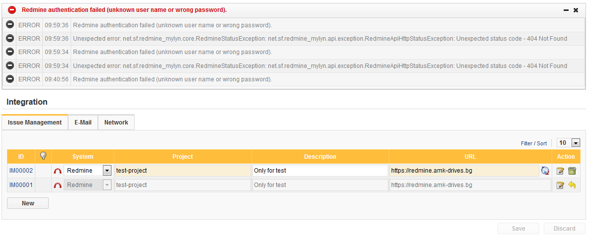

When I try to connect I receive this error:
ERROR 09:59:36 Redmine authentication failed (unknown user name or wrong password).
ERROR 09:59:36 Unexpected error: net.sf.redmine_mylyn.core.RedmineStatusException: net.sf.redmine_mylyn.api.exception.RedmineApiHttpStatusException: Unexpected status code - 404 Not Found
