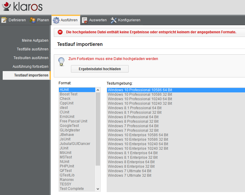

KLAROS-2755 is solved, but I am using TestComplete 11 and Klaros 4.5.0 - Build 3101 and get this error message when trying to import the Testcomplete report ZIP file:
"Die hochgeladene Datei enthält keine Ergebnisse oder entspricht keinem der angegebenen Formate." (see screen shot attached).
Does KLAROS support the report format of TestComplete version 11 or is the ZIP not OK? (also attached)

RE: TestComplete - importing test results (Antwort)
Hi Peter,
the zip result file format is not supported as it does not contain useful parsable information.
Can you please try importing the .mht file produced by TestComplete?
Both files you added are missing the parsable xml result files (we are especially looking for a file called root.xml here).
I think you are missing the /exportLogToXML command-line argument when running TestComplete. See also: https://support.smartbear.com/viewarticle/73133/
Youngling Beiträge: 5 Beitrittsdatum: 29.01.16 Neueste Beiträge
Oh, I missed that. Now it works.
Thank you, Torsten.
