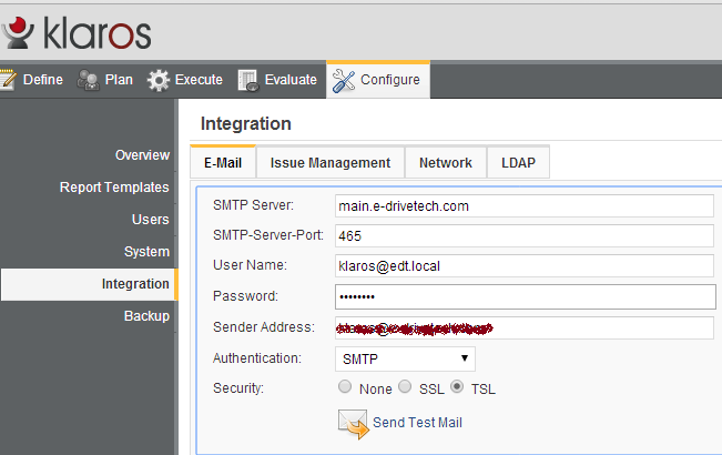

Angel Guillermo Hidalgo, geändert vor 11 Jahren.
RE: Mail notifications
Padawan Beiträge: 62 Beitrittsdatum: 20.12.13 Neueste Beiträge
Hi Patrick,
In the attached file you will find my mail configuration.
If I click over <Send Test Mail>, Klaros will send to klaros@edt.local? What happens with Password?
I need to verify sending a mail to only one user.
Thanks in advance,
Angel
Thanks in advance,
Angel
Torsten Stolpmann, geändert vor 11 Jahren.
Hi Angel,
if your mail server requires password authentication you would need to activate the SMTP selection as shown in your screendump and add a valid username and password to access it. In most intranet settings this is not required and you should select authentication None and omit username and password here. You probably need to ask your local administrator about required authentication settings if you are unsure about this.
As Patrick said, the test email will always be sent to the email address specified in your user account in Klaros or it will complain if none is found.
