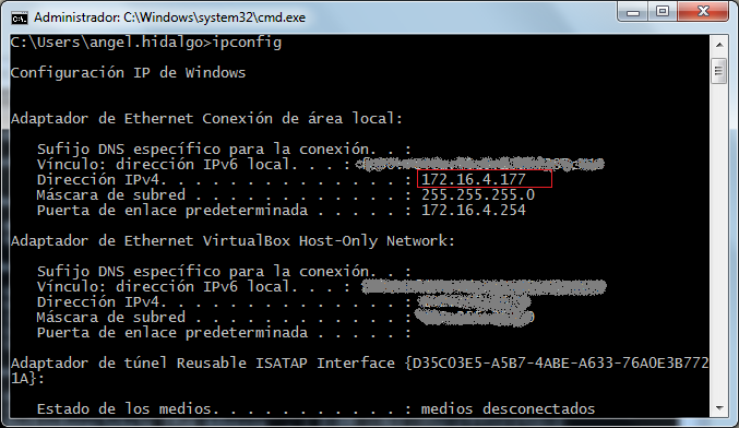

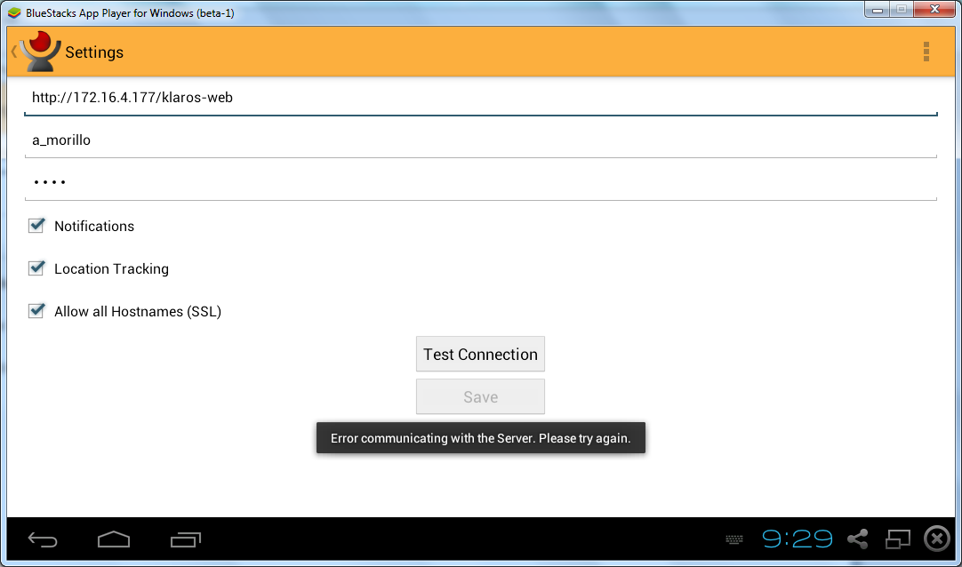

I guess, I have to enter my IPv4 on Bluestacks configuration. I did that and I have these results (see pictures):
What's wrong??
Angel Hidalgo

Hi Angel,
You need to specify the port number (18080 by default) in the Server URI field. In your case, this would result in the following URI:
http://172.16.4.177:18080/klaros-web
If you have changed the default port, you'll need to replace 18080 with the respective port number.

You are right. Now Bluestacks is working.
Thank you Fabian

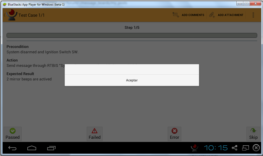

I was testing Klaros in Bluestacks, but when I wanted to execute one of my jobs assigned, I got a message (see figure window_after_press_execute.png).
I don't know what's saying, anyway I pressed <Aceptar>.
After that, I got a window with the First Step of my Test Case. I press over <Passed> button, but the procces does not continue. It is returned to main window.
Do you know, why?
Thanks in advance
Angel Hidalgo

Hi Angel,
we couldn't reproduce this behaviour. Does the empty AlertDialog appear everytime you execute a Job? Have you tried executing another Job?
Otherwise it would also be helpful if you could provide us the Bluestacks log. If you're using Windows Vista or later, you can find the log at
C:\ProgramData\BlueStacks\UserData\Logs.
If you're using Windows XP, the file is located at
C:\Documents and Settings\All Users\Application Data\BlueStacks\UserData\Logs

Hi Angel,
Have you tried turning off location tracking in the app settings? If this option is turned on, the Android System tries to retrieve the location of the device via the Google Play Services API.
I suspect you're experiencing this behaviour since the BlueStacks App Player doesn't provide location information and presumably hasn't the Google Play Services installed.

Hi Fabian,
You are right, when <location tracking> is on. I get that problem.
I disabled it and Bluestacks are working.
Thanks so much.
Angel Hidalgo

Hi Angel,
I'm glad I could help.
I'll put a note in our documentation saying that location tracking should be turned off when using BlueStacks.
