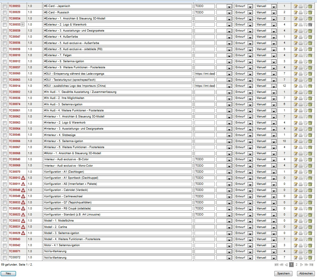

we do have real trouble here.
in one of our projects we have an issue after adding a new testcase.
reproduction:
1. adding new testcase
2. after autom. refresh of the the page most of the testcases a marked red (are modified) !!!
3. the new id of the new testcase is not yet shown
4. saving the change
5. all headlines are moving one testcase down > headline and content/steps are not matching anymore !!!
6. we see some error messages: attachments can not be found
we do have a lot of work to fix the database again.
at the moment we have to freeze our work because it is happing mostly all the time.
see screenshot.
please try to assist us because it is very hard to get the data mixed up all the time.
many thanks.
roy

RE: adding new testcase mixes up all headlines !!!
Hello Roy,
Can you please state the version of Klaros you are running?
We had been struck by this IceFaces bug in the 3.6.x line before but it should be fixed since months ago (there is a potential race condition between client and server table model here).
To avoid adding wrong entries please cancel your changes if you see multiple lines changed which you haven't touched.
Just a quick addition.
- Please reduce the amount of test cases per page (this significantly lowers the chance of triggering this)
- Refrain from clicking while server requests are in progress (the blue balls are moving)
- Do not save when you save suspicious changes in your lists, cancel will revert this before damage is taken
- A fast database backend may help as well
We did our best to circumvent possible situations which trigger this bug, but I fear a final solution will only be available in version 3.8 as we are finally switching from IceFaces 1.8 to IceFaces 3.2 in this release.
I still wonder why you are able to trigger this situation.

Torsten Stolpmann, geändert vor 12 Jahren.
The just released version 3.7.7 contains an updated version of the Icefaces library which should now be able to effectively avoid this error situation by blocking UI activity during page submits.
